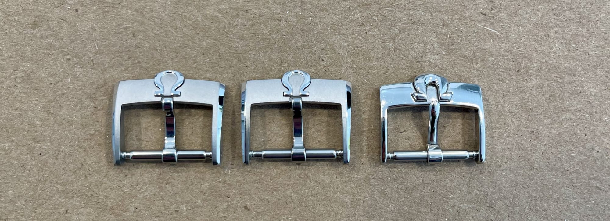

Almost every clasp offered for sale cheaply on eBay is a counterfeit component produced to very low standards. These buckles are cast, not machined from a single piece of metal, making them significantly weaker than genuine Omega buckles.
This weakness allows the buckle to bend, often enough for the spring-bar to come loose and allow your precious watch to fall to the ground. Even the stampings stating that these buckles are stainless steel are illegitimate, they are made from whatever metal was available cheaply to the producer, and they will often rust.

This clasp, sold new on the Omega CK859 is still in active production by Omega, and while it costs north of $100 USD, you absolutely get what you pay for. If you examine the photos below, you'll notice that the buckle itself is machines from a single piece of stainless steel with a satin finished body, complimented by a polished Omega logo in the correct vintage Omega shape, with polished sides and tongue.
This is not a fragile or easily bent component, unlike the poorly cast rubbish often found online for sale, and even the tongue itself is attached with a closed loop, not merely a bent piece of metal.
