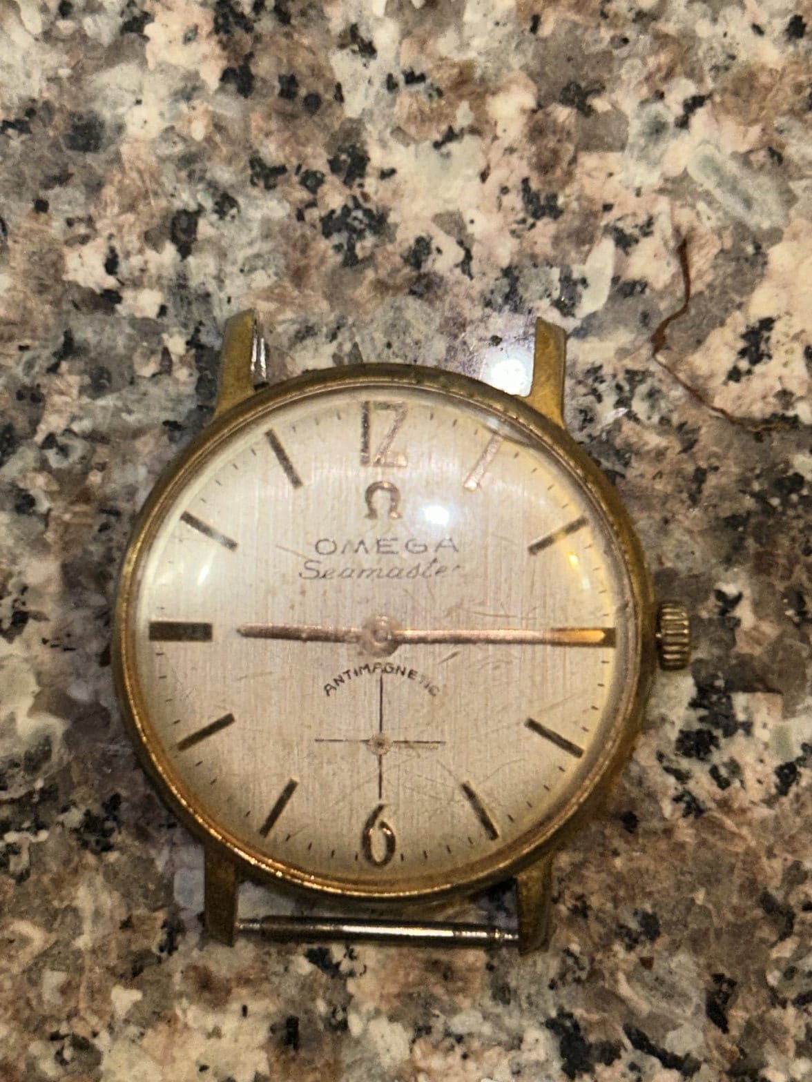

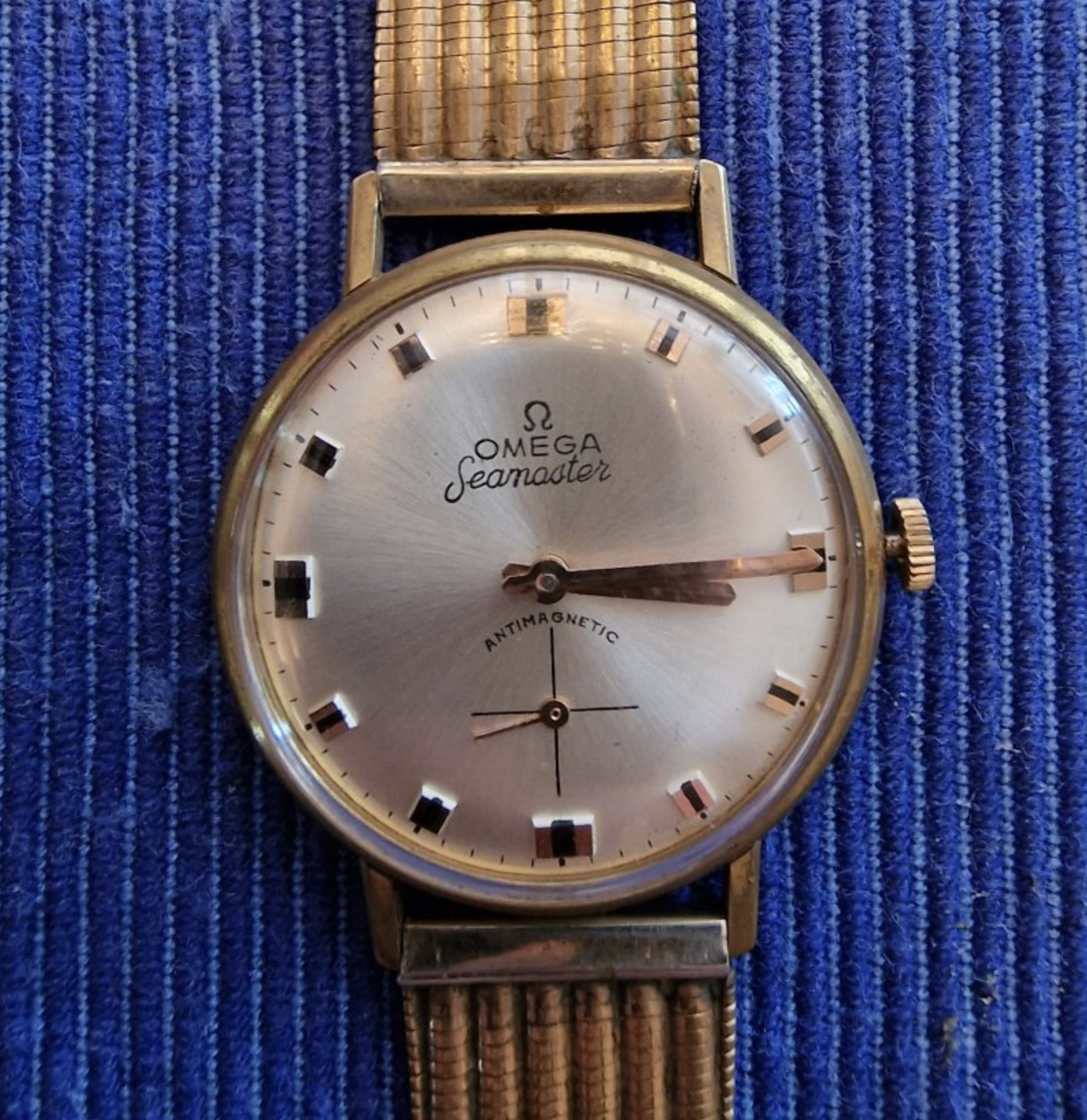

Is this Vintage Omega Seamaster Antimagnetic 0.750 18K Gold Real?

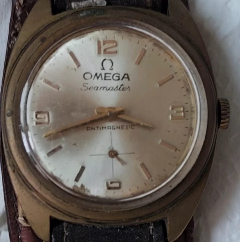

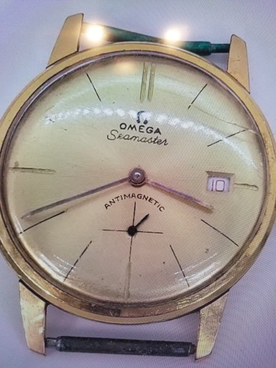

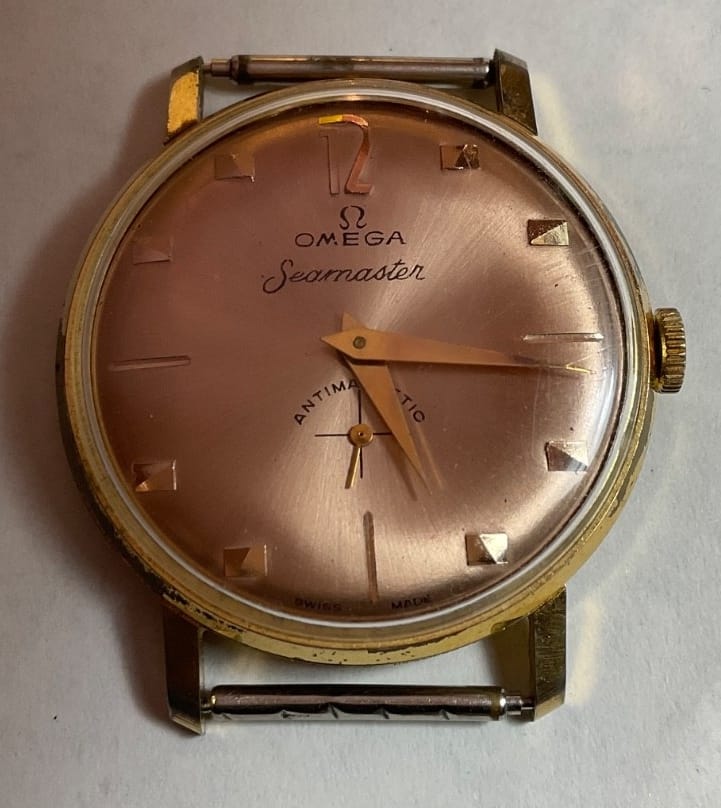

That 'Omega Seamaster Antimagnetic' stamped 18K Gold 0.750 is not real, no genuine Seamaster says 'Antimagnetic' on the dial. Here's how to spot the fakes.

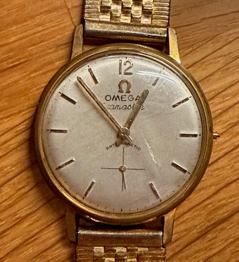

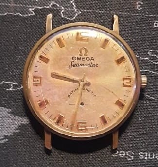

Are these Vintage Seamaster Anti-Magnetic 18K Gold watches real?
No, none of them are real. Omega has never made Omega Seamasters that look like this with the words Anti-Magnetic written above the sub-dial.
Similarly the watches with "22 Rubis" written on the dial are also counterfeit.
These watches are old knock-offs made in extremely large numbers, and we see them many times a month, sometimes many times per week on Omega Forums when people ask if the watch they have bought or inherited is real or fake.
There is a MASSIVE thread with 118 pages, and over 2,350 posts on Omega Forums here discussing these frustrating watches as there seems to be no end to them.
Don’t fall for a Fake vintage Omegas! Post them here (Not for questions)
Here are some tips to help you avoid purchasing a fake vintage Omega. Here’s a classic fake Seamaster: First, you won’t find “antimagnetic” or a jewel count on the dial of any Seamaster. Second, that’s one crappy movement. Omega copper plated their movements since the word Seamaster…

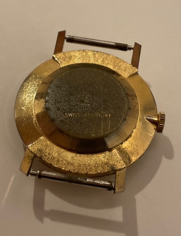

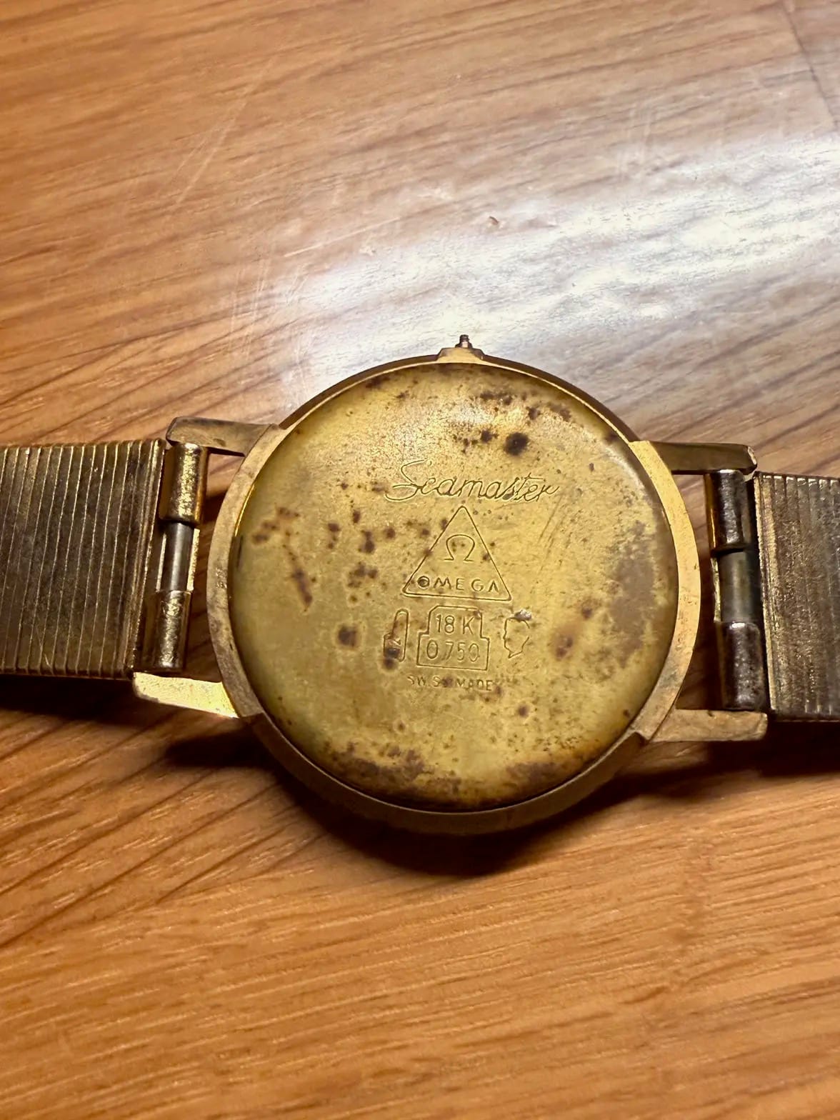

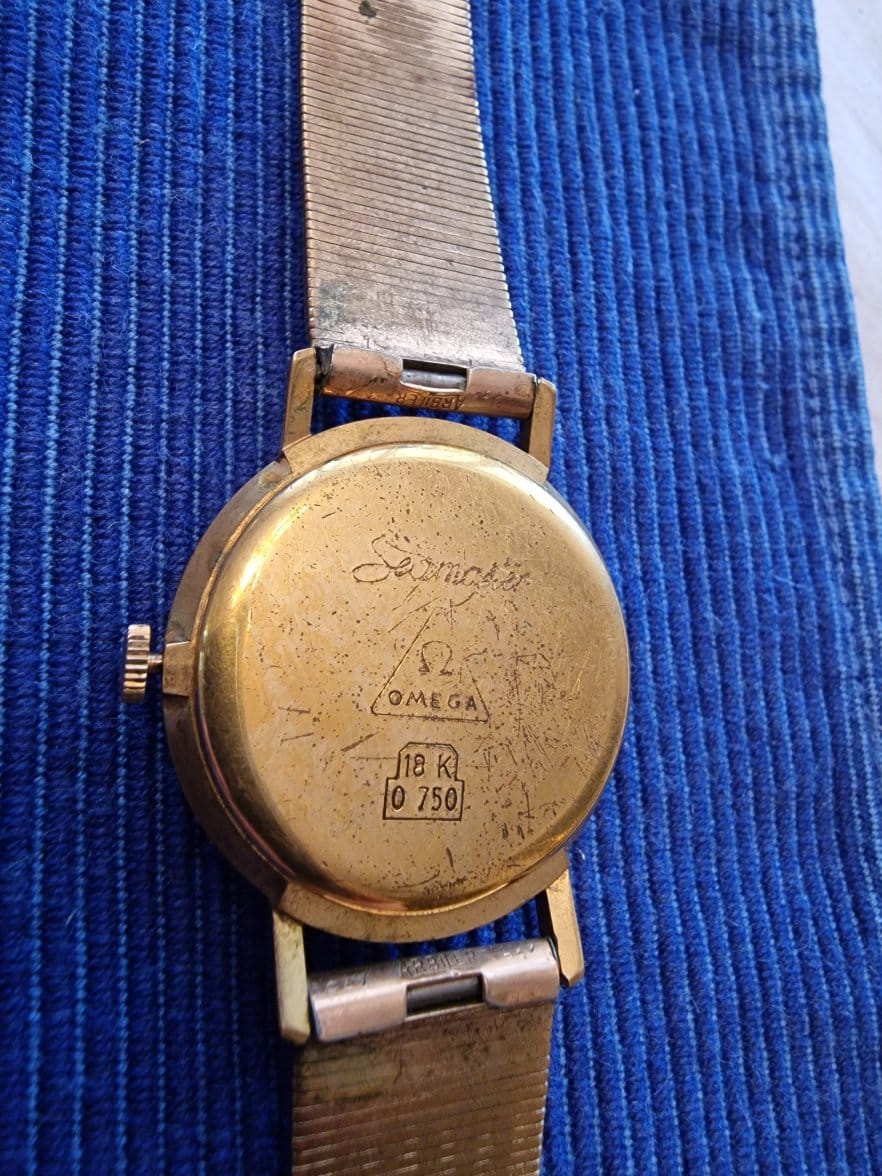

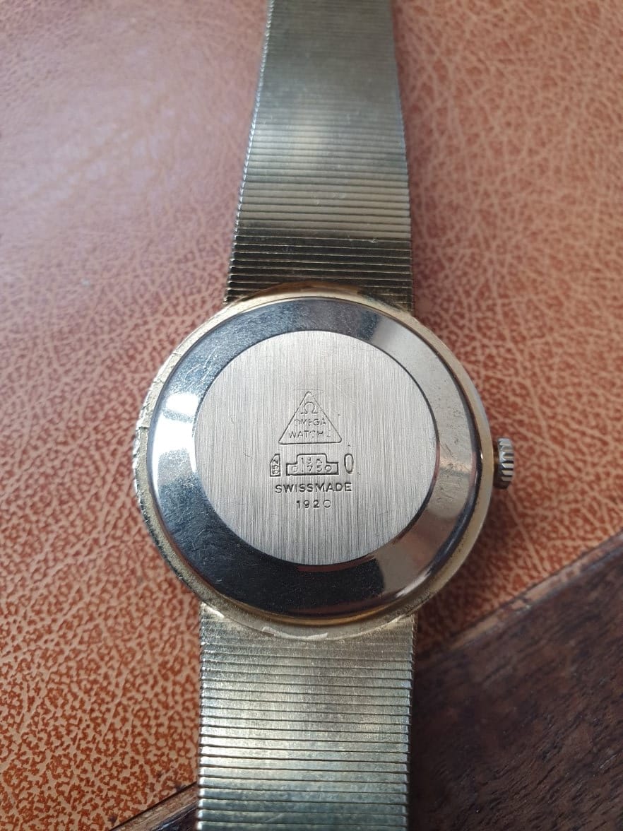

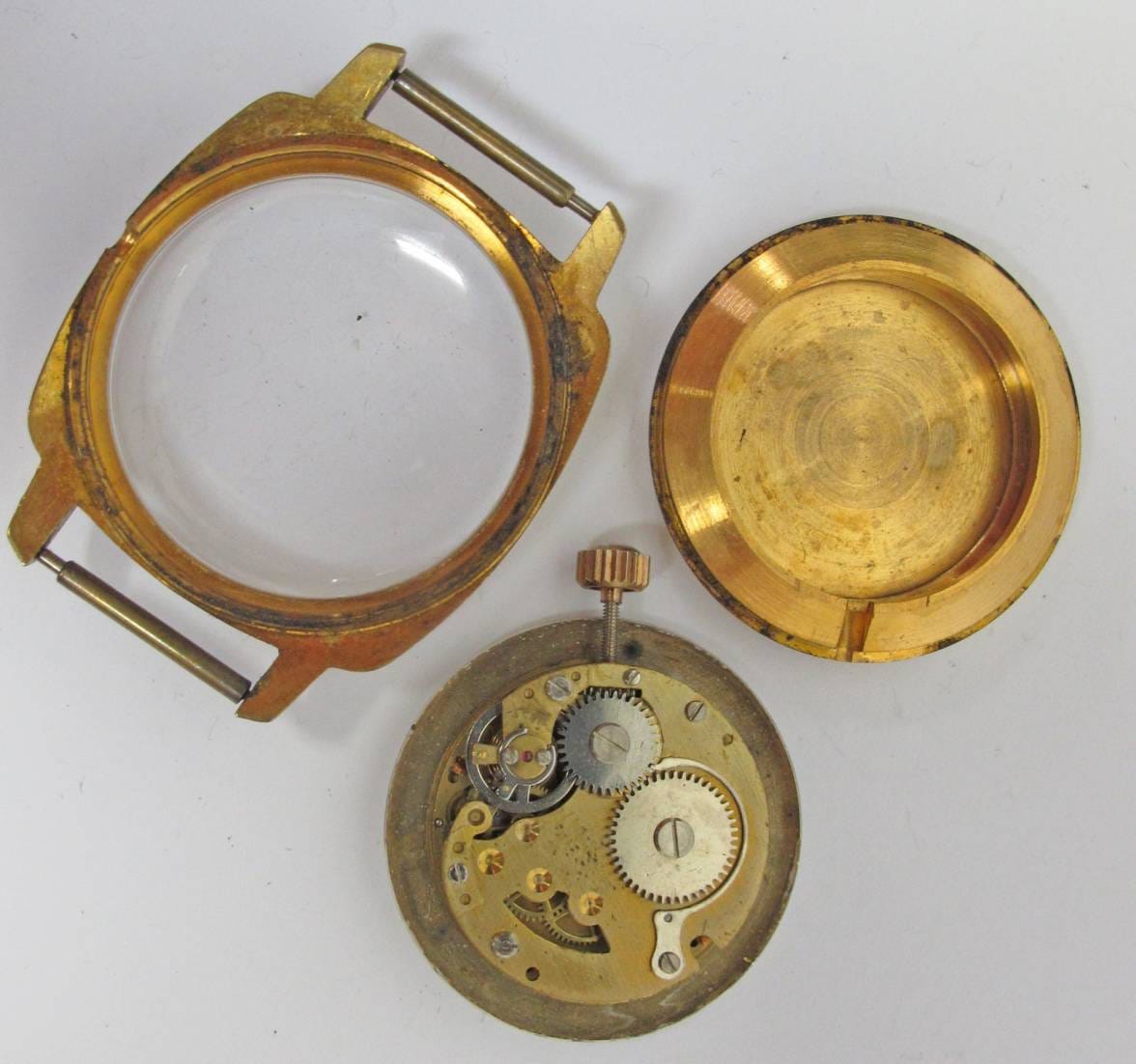

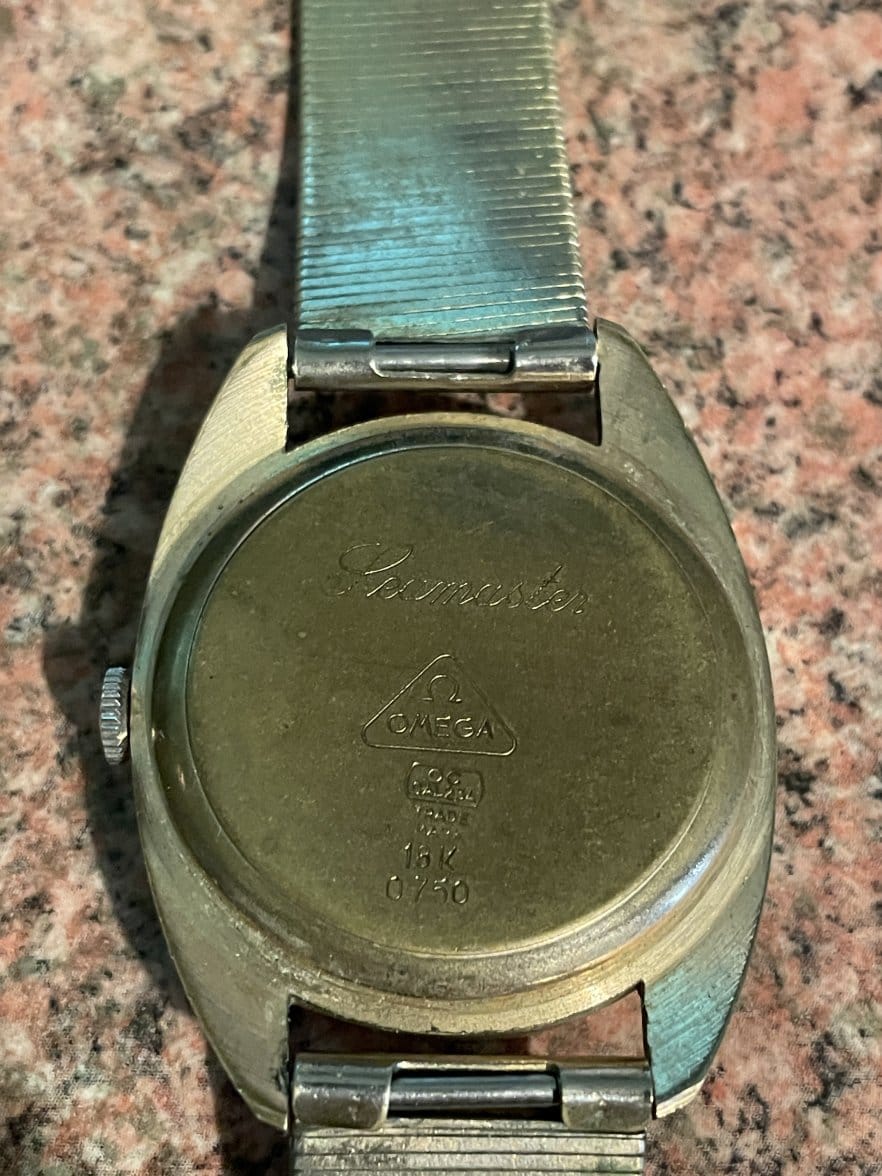

Are these Seamaster anti-magnetics made of real 18K Gold?
No, these watches are made of cheap base metal, not even a real grade of stainless steel, with a light plating of gold.
Nearly all of them wear through, have the gold coating flake off, or corrode with time as they were not meant to last, only to fool people for a short period of time before going in the trash.
There is no melt value or potential to recover gold from this watch, this includes not only the case but also the dial furniture and hands.
The hallmarks on the back indicating they are real gold are both illegal, as well as entirely wrong as these particular markings are found on the INSIDE of the case-back on real Omegas, with additional hallmarks finely stamped on the lug, or between the the lugs (US market).

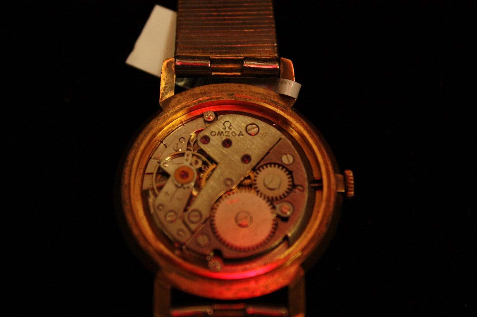

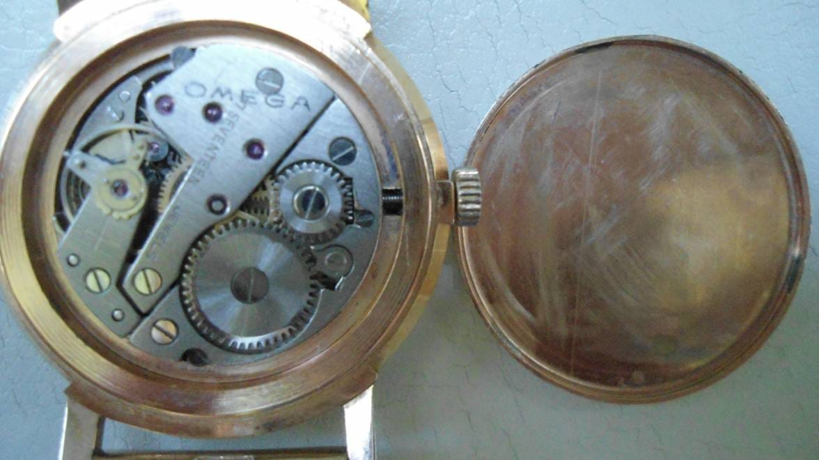

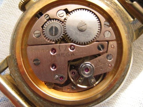

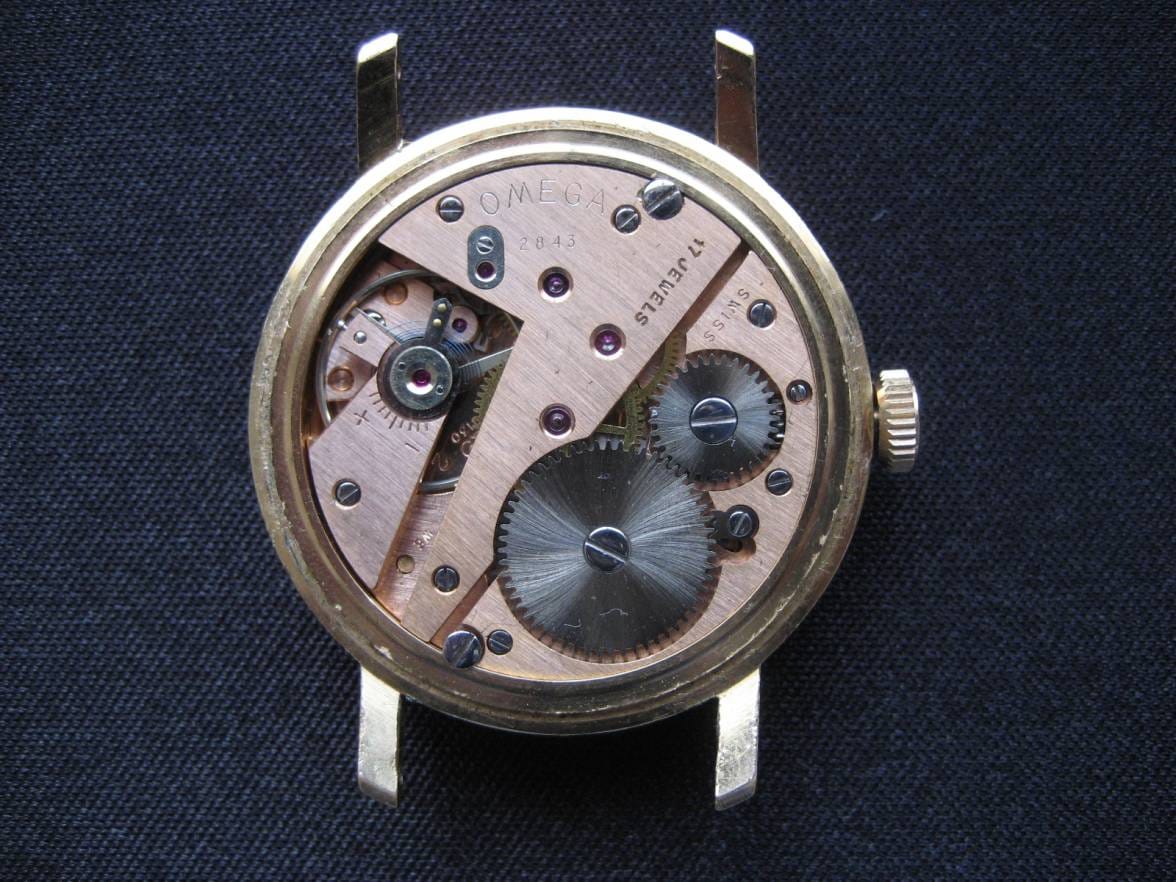

What about the vintage mechanical movement inside?
The movements found in these watches vary wildly, so just because your movement doesn't look like one of those below doesn't mean yours isn't a fake in this category.
The makers of these fakes used whatever movement happened to be most available at the cheapest price at the time. Some have cheaply made Swiss movements, some have eastern-European movements, some have movements from Asia.
Often Omega is written, stamped, or engraved on the movement but the finishing is far below the standards of a real Omega, and these movements are not of value to collectors.
The only potential use for them is for beginner or hobbyist watchmakers wanting to practice on something they don't mind destroying.

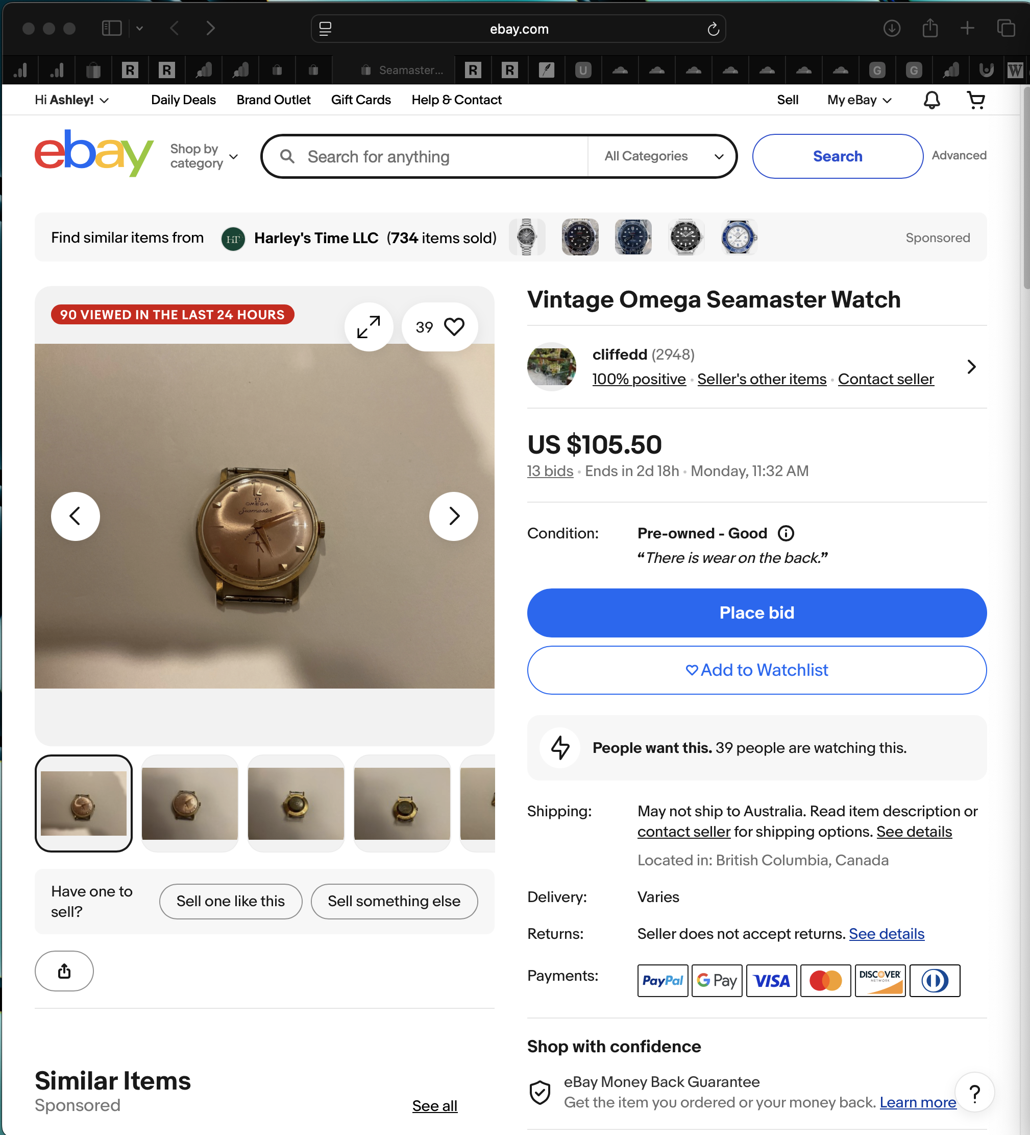

Is my vintage Seamaster Anti-magnetic 18K worth anything at all?
No, please don't try to sell it even as a novelty or a joke gift. These watches contain no value, except as practice dummies for absolute novice watchmakers.
There is no reason for these to still be in circulation at all, and by passing them on to someone else, knowing what they are, you are allowing someone else to be scammed down the line.
If you purchased one of these watches, not knowing it was a forgery, pursue the seller for a refund as quickly as possible, using PayPal, a credit card chargeback with your bank or any other method at your disposal.
