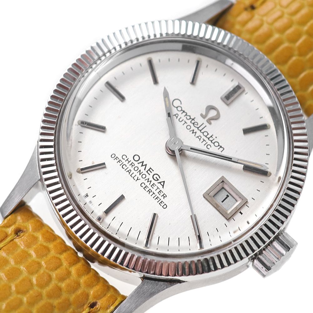

It's hard to find a modern Omega that is anything like this case design. It borrows the beautiful 18K gold coin edge bezel from the Gerald Genta penned C-Case Constellation line, but fits it to a contrasting brushed case and more Seamaster inspired lugs. The end result is a watch that looks quite similar to a current model Rolex Datejust, but with a more sporty design due to the thinner brushed lugs.
The case is relatively small at 25 mm, but thanks to the quite thin movement, the watch has an overall thickness of only 9.5 mm. It features a large knurled crown, and 13 mm lug width.
The watch case comes in three versions. The first, and most common, is a stainless steel case with an 18K white gold bezel. The second is nearly as common and features a 20-micron gold plated steel case, with an 18K yellow gold bezel and steel case-back with gold observatory medallion. The final case is an entirely 18K yellow gold, and while it may be possible for a white gold version to also exist, none of have been seen thus far.
All cases have a standard keyed screw-in case-back and given the high survival rate of dials and movements, the water resistance is at the least quite decent for a ladies watch of this era.
These watches are often seen on leather straps, however there is also a beads of rice style bracelet that fits the 13 mm lugs, which draws even more parallels with the ladies Rolex Datejust due to its similarity to the Jubilee bracelet.

All three dials share a lot in common. They all feature a vertically brushed dial texture with applied Omega logo, date window and dial furniture with black inserts atop. The also all have Constellation Automatic printed at the top of the dial and Omega Chronometer Officially Certified at the bottom in black. They all also feature hands matching their metal color, with black inserts as well as luminous material against dials also with luminous material.
There are however several small difference between them that make each unique to its specific case type.
Stainless Steel
The stainless steel is simple and quite elegant. It features a silver brushed dial, silver dial furniture and applied Omega logo, and a matching silver date wheel. The furniture, hands and dial combine to compliment the coin-edge bezel beautifully and this design looks terrific whether on strap or bracelet.
The black inserts in the hands and on the dial furniture allow for excellent contrast and legibility which is important given the small size of the watch.
